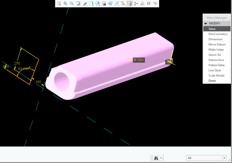

So, I tried it.  Here's the mapkey:   "  mapkey my #DONE;#MODIFY;#VALUE;  "
   -  (I made it "my" because it didn't conflict with any of my other mapkeys, but it can be any keyboard letter or combination.)
Just type the mapkey, then click on a feature or assembly.  Works for picking in the window, or picking from the model tree.  No more pick, hover, pick crap of the current UI.  AND  you can pick multiple features or combination of features and assembly elements.  !!!  I'm so excited I've been dancing around!
The #DONE; sets the stage.  It works with just #DONE;#MODIFY; most of the time because VALUE is the default.  Adding #VALUE; forces it (in my little tests) to work all the time.
Here's an example in part mode.  You can see dims for a curve, a round, and an offset all on the screen at once!  Just click the dim you want and the box pops up to enter a value.
Here's an example with an assembly.  Works exactly the same as described above.  In this case it's showing dims of 3 different parts all at once.  Notice that the assembly version of the Menu is a little different.
Here's the same assembly after a modification.  You can see the feature dims AND the part dims (0.200) at the same time, with one click.  No hover time, no selecting multiple things in the model tree, no setting filters so you can get both parts and features.  This is SSSSOOOOOOO much faster - and it's consistent for both parts, and assemblies.
Thank you @TomU .  Thank you very much for pointing me in the right direction.  This speeds things up a ton.  Probably saves 3-5 seconds every time I want to see or change a dimension.  10 - 15 seconds if I want to see a few dims -- AND -- I don't have to remember dims from one view to the next.  SSOOO Wonderful.  THANK YOU !!!

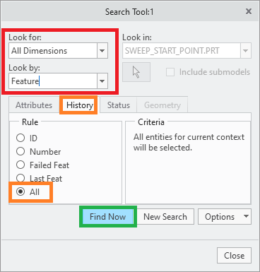

try Search Tool

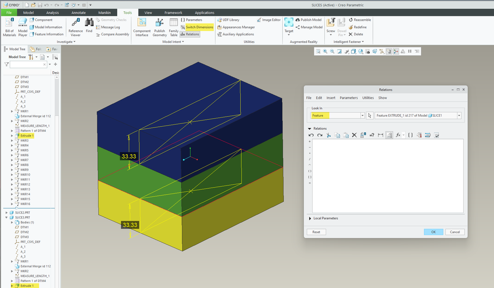

@MartinHanak Thank you for showing this.  It does show dims from multiple features.  Could not see how to choose only specific features in multiple models (unless they all happen to have the same feature number 🙂 .  Also, I don't see how to interact with the dims once they appear.  Can't modify a value, for instance.  The dims continue to show even when the tool is closed, but I can't interact with them.  I can see that this tool is valuable in some situations, so again, thank you for showing me.
(To:ByDesign)
The relation editor function can be used to do this.  To display the dimensions for multiple features from component models in assembly mode see the picture below with an example displaying feature dimensions from two components within an assembly.
ByDesign
(To:tbraxton)
@tbraxton  Thank you.  Yes, this also works to see dims from multiple features.  And, you can select only specific features in multiple models.  But, with limited interaction.  For fun, I picked dims, then assigned them a value in a relation, then regenerated, then went back in and deleted the relations.  It does work, but that's a terribly arduous workflow.

@TomU , You are BRILLIANT.  Thank you.

I dug up an old config.pro file from R20 and took a look at the modify mapkeys and found one for modify value it matches what you posted above:
mapkey mv %.dr;#modify;#value
.dr is a mapkey that would crawl up the menu manager structure to the top level menu if you were active in a sub menu to ensure the execution of the mapkey
