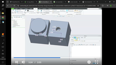

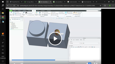

i was told by my teacher to create parts from each body from the master part (like in the pic), in order to assemble them in asm like in real life. it automatically creates an External Copy Geom when i press it
i saw the video and understand i need it as a real part and not as External Copy Geom, but i didnt find a way to do it from the master part like the teacher requested
second video attached.
Martin Hanák
my problem is that the dx:y doesnt show,
in the video u chose p2 (part) and not p1 (sub-assembly).
in mine i have 2 sub-assemblies and when i choose a part from the External Copy Geom it doesnt show dx:y other then a 0-valued one (i think its from a sketch for a dtm plane)
so i tried changing the look in to part: 
but it still wont show dx:y other then the 0-valued one
(i apologies if the video doesnt work)
