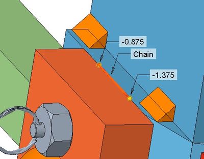

Can you tell me what is the sequence to create a square weld? I selected the orange surface, then the blue surface, then the edge between them, but no weld bead was created. Clicking the checkmark, the dialogue box says, 'feature failed to regenerate'. Thank you.

I don't think you pick surfaces for butt welds. I'm not an expert in welding app at all, so maybe its only my hack.
I select the edge on each and if one of them is too short or tool long, you have to go details - options to set the ends (dimension or to reference)

Thank you, Stephen. I'm gonna punt on this for now. It doesn't seem to like the fact that there is no groove actually modeled. When there is a gap between the two surfaces, it generates the weld. Even then, the weld is displaying flush to the top of both surfaces being welded together instead of having a convex shape, so it's difficult to discern the actual weld, which is why I wanted to model the weld to begin with.
