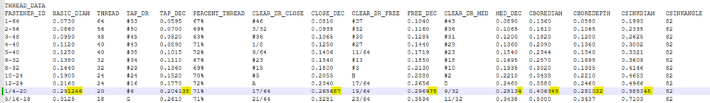

I'm not seeing this problem in Creo 9. If I modify a .hol file to include values out to six digits, all of the digits are used in both the hole parameters and the final hole sizes.
Extra digits added for testing:
Hole feature parameters:
The precision is still there, it's just that the display is normally rounded to three decimal places:
Using the standard parameters in the notes with the [.<number of decimal places>] syntax will show more than three decimal places.
While I would need to do additional testing to see if it's possible to have everything default to four decimal places upon creation, it does seem like the precision you need is already available, at least in Creo Parametric 9.0.

The way the hole feature in Creo is currently implemented, I don't think you will be able to get a different number of decimal places automatically displayed based on fastener size. While there should be no problem making all of them 3-place, or making all of them 4-place, it would probably take an enhancement to get both (either one) at the same time automatically.
ASME Y14.6 DOES call out decimal places out to 4 for .3125 etc. This spec is referenced by Y14.5 for how to call out threads, and so far we're using the 2009 version of Y14.5, and in fact JUST moved to that from the 1994 standard I'm certified in. I'm going to get re-certified in the 2009 spec this year.
Actually, I take it back. There is a way. You can add custom columns to the .hol file and then use those in the hole callouts.
So, adding "MY_HOLE_SIZE" then creates a parameter?
Correct. Any additional columns added to the .hol file will be parameters in the hole feature.
Cool! Thanks! Maybe I'll try again then, and just add text as needed. Weird that every time I changed the .hol file, NOTHING changed. Something strange is going on.
Ok, another question: How does it know what kind of parameter to make? Does it make a string parameter if there's characters OTHER than numeric, and make an integer or real number parameter is there is only numeric characters? I guess I could make it work by simply manually typing out exactly what the thread should say instead of using any other (threads_per_inch, etc.) parameters as a combination.

Lol. I don't know. I fought with that as well. It seems like if only numeric characters (and decimal) are present the parameter is REAL. If any other characters are present it becomes a STRING. I'm not sure if there is any other logic to it. I certainly couldn't find anything documented. That is precisely why I included TPI in my example column. 🙂
