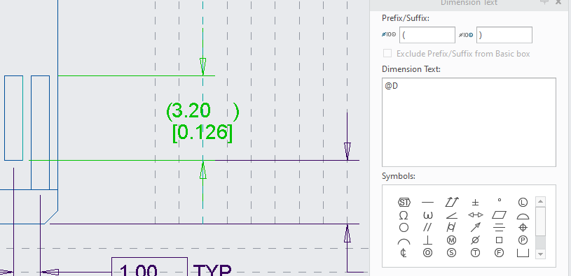

Hey,
I'm trying to find a way to keep a reference dimensions looking like (3.20) instead of (3.20    ) when I use dual dimensions. The only fix I've found so far is to manually override the dimension, but that's a pretty terrible solution. There should exist a way to prevent this formatting error through the software setting.
Photo attached below to show what I'm talking about.
Any advice on this is welcome!

The "Suggest an idea" button is grayed out, so I'm guessing I don't have the right license to use that feature of PTC community. However, this seems more like a bug that needs fixing than a new feature to be added.
I suggest you to report the problem to PTC Support.
From my point of view the problem is related to drawing option dual_dimension_brackets.
1.]
If drawing option dual_dimension_brackets yes is set then extra space is displayed before right parenthesis in primary value. This is because right parenthesis is placed after right bracket displayed in secondary value.
2.]
If drawing option dual_dimension_brackets no is set then brackets are not displayed in secondary value and right parenthesis is placed correctly.
