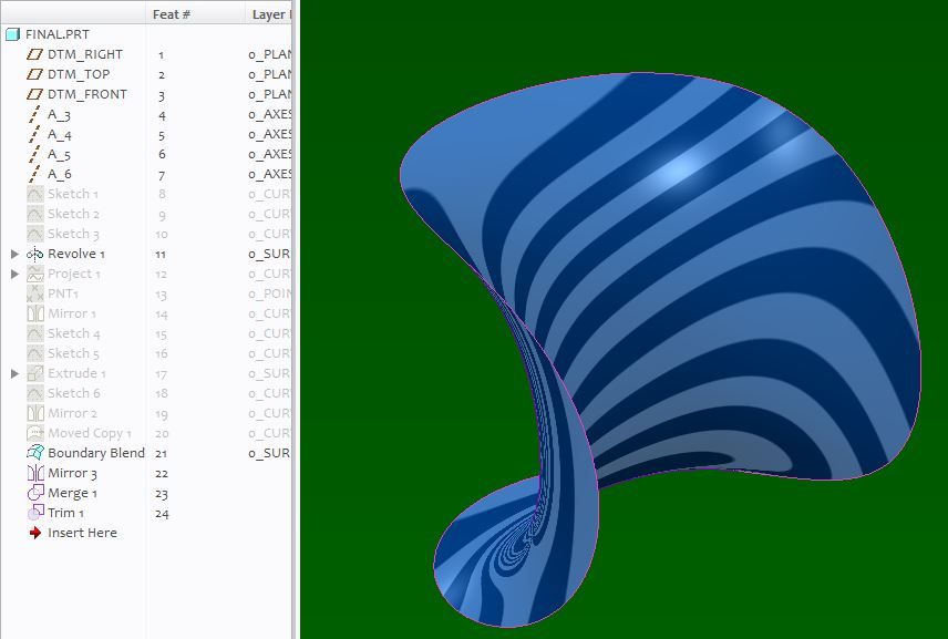

Hi, I have tried approximating the simplest form of the above surface but the results are not satisfactory. I am sure this can be modeled with a better surfac equality, just that I do not know how.Capture.JPG
  i attached here the original IGES file retrieved from internet and the step file of my own version. May be some of you could help to look at it and share with me the better way to model this surface. Many thanks in advance.

THANKS. This is definitely another of modeling that shape and it's really a simple way.
I have also managed to improve the surface quality further as shown below:

Thanks, this quilt is very smooth! Only thing I am unable to do is to offset it, might be due to its degenerate corner. I am sure this can be improved.
