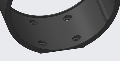

If you see the holes above, they are not something that you can easily start from the rounded side of the bracket. So creating the holes from the flat part underneath is very desirable. I first placed the four inner holes and then created a separate feature for the counterbores. To do this I needed to create a plane for the counterbore sketches. In SolidWorks, I would have just sketched on the flat face and then started my cut at the offset distance without needing the extra plane.

You can realize something similar but it is probably not the best approach in Creo. You can use the second direction for an extrude and apply a negative value to get the offset to start the cut. However there is a caveat that a solid extrusion can only add or remove material, not both in the same feature. So you can create your offset c'bore using an extruded surface in both directions with capped ends and then solidify the quilt to remove material making the bore.
The better method would be to create an embedded datum feature in the bore cut or use a revolved cut (for both hole and c'bore) where the offset for the bore is controlled in the sketch or a custom hole feature with the offset within the hole shape.
Typically - in this scenario, I would want the elevation to be common for all the reliefs/cuts that would be made. So using a point to control the start point (much like a plane would be as a starting point) can be used if you are referencing/creating sketch geometry from another reference.
Here is how that would work/look when done using a From Selected reference ... then projecting To Next.

Thanks, that seems to work. A little confusing but keeps it all in one feature without needing additional construction geometry.
