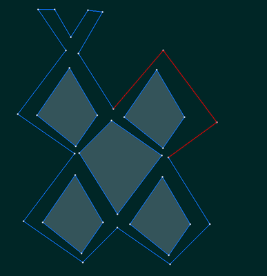

I'm trying to make a stent but creo identifies wrong sketch as a shape
철박_10230212
I'm designing a simple stent but it seems that the sketch i put as a hole identifeis a shape. is there a way in creo to set which is a shape and which is a hole?

I think the problem is in this area of your sketch:
This works:
and this does not:
those 2 look close but they aren't connected thx for the possible solution tho
Well then, if they're not connected, then the area marked with "X" not "enclosed", is it?
That explains why it isn't shaded...
that's the thing i dont want the diamond shaped parts shaded i want every thing else to be
there is a somewhere in your sketch where the loop isn't closed.
This works:
and this doesn't:
Since I don't see any highlighted-in-red open endpoints, it makes me think that your sketch has a duplicate line which
overlaps another one in the boundary loop, e.g.:
Use the inspect tools to find the problem geometry:
i found that i had a few overlapping lines in blue I erased and placed them again and they still turn out overlapping is there a fix to this?
If you are still using the original sketch, the issue may be what @pausob mentioned earlier.  A point touching an enclosed sketch does not work.  Creo can not determine what should be enclosed.  This sketch does not have any overlapping geometry, but all line are highlighted because of this issue.
In your sketch it appears that you have erased the wrong line sections across the top and bottom.  The partial diamonds need to be capped for them to be shaded.
@철박_10230212 , not sure what you are asking.  a fix for not making overlapping lines?
Can you save your section and post the .sec file?
Maybe it exposes a Creo software bug, or an issue where the sketch shading algorithm fails if loop vertices get too close?.
