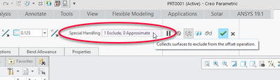

Alternately, if you do bring in all solid surfaces, you should be able to use the Special Handling area to remove surfaces that are considered for the Offset operation.
