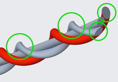

@tbraxton your solution works fine. I had not the time so far to rebuild it myself but the separation of the sweeps seems logic even though I would like to avoid the second sweep "spiral" as an reference for the main spiral of the "wire". When I want to introduce more than one spiral, it will turn into a "non-round" shape:
Is there any way to avoid this behaviour and to keep it round, all the way of the spiral?

The distortion can be eliminated by sweeping a twisted ribbon and sweeping a solid along the outer edge of the ribbon.
Here is an example of the ribbon method created in Creo 7.
