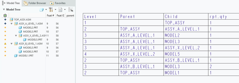

Hello!
To create a report for Fire Certificate Inventory List (EN 45545) I want to use a repeat region of my top-level assembly.
For every part, I need to report the assembly where it is mounted.
Is there any option to report the Part Number (or any other parameter) of the immediate upper level?
I hope the picture below can explain this case better.
Thanks!
I did it with a Repeat Relation.
As far I see PTC will do a Depth-first search. And this is only one solution I guess..
You must have rpt.level and asm.mbr.name in your repeat region, else you don't have access to the corresponding vars.
The relation will be evaluated not recursively in Creo with a new stack, so the var values will be keept during this while/for Loop.
In Level 1 your Parent is empty "" and you save the name in lev1.
In Level 2 your Parent is lev1 and you save in lev2 the name
In Level 3 your Parent is lev2 and you save in lev3 the name
... and so on
You must have this for the amount of levels you expect.
PARENT is a Repeat Relation Var -> rpt.rel.parent, and must be added.
Here this example stops at Level 4, Level > 4 will set a static text, to force a relation edit.
I kept the relation easy to maintain, no "else"

  • image001.pngIs this what you are looking for?
  • Done with OOTB Creo!

Hello.
Yes, that is exactly what I need!
Could you explain how it is done?
Thanks.
... and so on

The example table is attached.
