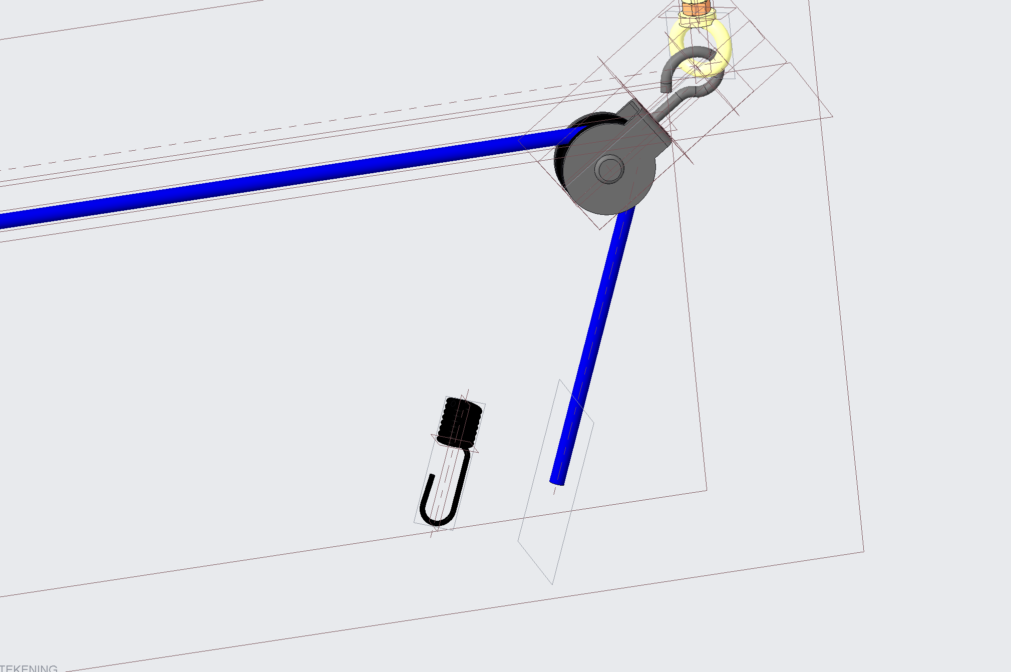

i have an assembly of a rope with a hook on it. but for on the drawing i want to rotate the hook 90 degrees so you can see its a hook.
i used exploded view for this. and to move some other parts.
this works for the current width of the assembly (my assembly chainges width based on a parameter).
but for anny other width this rotating action seems to be done using the point(axis) in space where it used to be. resulting in the part moving away from the rope.
the yellow eye nut in the picture also gets rotated 90 degrees, but this axis is in the width directon so its fine.
does annyone know how to get it to use the actual rotation axis instead of the point in space it used to be in?
