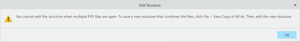

Unfortunately, this does not currently help me, as I am unable to insert another PVZ file into my existing parent file, which still contains one of the original embedded viewables, using Edit Structure. When I try to do this by clicking on Edit Structure, the following error message occurs:
When I follow this prompt, the parent file does get saved along with the embedded viewable, but all of my two dozen annotation sets are lost.

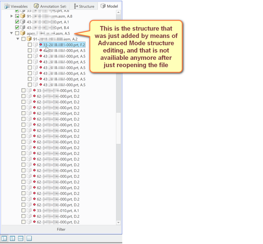

Update:
Unfortunately, adding a structure with advanced mode structure editing does not work either for me.
When I add a structure (a PVZ file) this way, save the parent PVZ file, close it, and then open it again, the added parts are gone just as often happened before with "added viewables".
This is even though the added structure is still present in the Model Tree. If I then click on a part of the added structure in the model tree, instead of becoming visible, it gets a red exclamation mark, whatever that means:
Anyway, adding and saving assemblies, viewables or structures doesn't work reliably no matter how.
After spending literally weeks on this, I am officially giving up -- with the conclusion that Creo View is highly broken in terms of handling added assemblies, viewables or structures.
