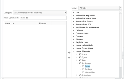

It refers to a "Show 2D View" button in the ribbon menu in the Sectioning tab, then the Setup group.  Looking at my Creo Illustrate, I see no such button there.
I figured it may be hiding, so I went into the ribbon customization menu, and looked for "Show 2D View", as well as looking at everything tool in the Sectioning Category.  I couldn't find anything
Would someone be able to let me know how me and my team can access the Show 2D View feature for sectioning in Creo Illustrate?  I'm probably missing something.
