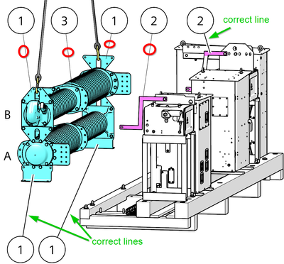

And I have just opened a CI file and I have this line setting problem again:
Four of the seven lines have lost their setting! That is @#!@##! 😞
