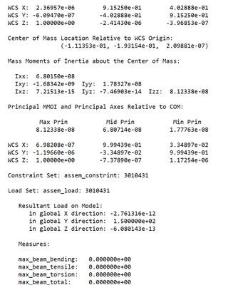

Without making any new measures, the result file will return the total load on the model (see below "Resultant Load on Model"). In many cases this should be enough to verify your input load to the system:
Also, reviewing the total load, as "SweetPeasHub" has suggested is also a great "pre-processing" verification.
