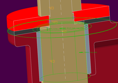

The contact pairs are well defined surface to surface and they do not have interpenetrations. Here are images the best I can without too much model detail.
Image with multiple interfaces failing:
Image of the definition of those interfaces:
It is worth reiterating that the issue is random. Sometimes these interfaces work correctly and other ones fail instead, so I don't see how it could be a problem with interface definition.
