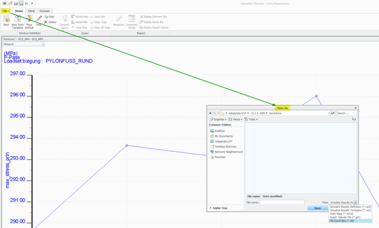

Below you find a screenshot of the graph I would like to export into a CSV or other format.
Within the post processing tool (Simulate Result) I was not able to export a CSV file. It was only possible to create a "rwd" file.

Thank you a lot for the solution. Somehow the xlsx is not created but the grt-file which already helps me a lot.

about the results not being exported as excel file, this seems to be a know issue and related to MS office security configuration.
For more details see  Article - CS413767 - Exporting result to an Excel file from the Graph (Chart-Tool) feature is not working in Creo Parametric.
_ This is affecting all Creo versions since 7.0
The official solution is:
_ "Temporarily disable any security labels or sensitivity labels applied to MS documents on the affected user's computer" - what in may case is a no go and not allowed.
_ Export the graph as tabular file format (.grt)
As it seems, until now exporting the graph as .grt file is the unique solution - although I dislike this formats since my excel has problem to right interpret numbers from this file having points or coma. A lot of manual correction is necessary.
Do not expect to have a good solution soon... If you use security labels or sensitivity labels applied to MS documents, this Creo function is gone...
