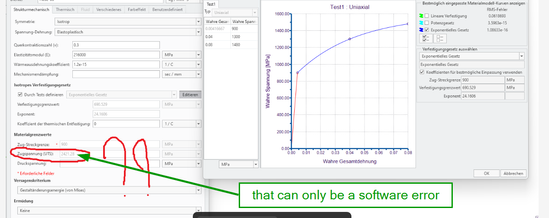

I have once again a problem with the definition of the material for my simulation with CREO... I obtained as Max stress 1500MPs which is in this case the tensile Strength because my simulation is non-Lineare.
I defined my material as follows but i don't get the desired result... can you help me in this case (Attached) ? The Tensile Yield Stress is 900Mpa
Thanks a lot...

What is the elongation at break? You have a high stress value at 3% elongation, is the material brittle?
the material is ductile. the high stress value at approximately 9% elongation

one more question: namely_: can the hardening limit be greater than the tensile yield point? Can you please briefly explain to me what the hardening limit is? is there any literature you can recommend me?

normally the strain hardening value is equal to the tensile strength value, for very ductile materials (->50% elongation at break). But in this case the elongation at fracture is 9%, so the calculated curve would not be optimal, for this reason in my example the strain hardening value is slightly higher than the tensile strength, but at about 9% about 1500 MPa is applicable.
Do you think there is an explanation why my tensile strength is 2421 MPa (attached), although I entered the same information here? do you know what the problem could be? the tensile strength here should add up to 900 + 690.529 = 1590 Mpa or ?

Usually this data is from real testing like ISO 6892-1.,
Also , best fit can be done for multiple sample tests or runs.
skunks
(To:SweetPeasHub)
You are right. The questioner only uses the yield strength and the tensile strength and the elongation at break. The value in between is selected, but the software seems to produce an error:
