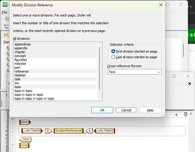

Now this works but in order to add these conditions to these elements, I have converted the elements from Unstyled (default) to Division 2-4. This causes an issue in my header which is supposed to display only header level 1 or division 2 using Division Reference.
However, it displays the first task/concept element irrespective of the division level. Note that this issue only occurs for the unstyled elements that are now Division style.

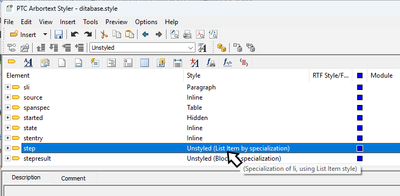

I'm glad that worked for you. In general with DITA, if an element is styled explicitly, you should make your modifications there. If it is unstyled, then that element is a specialization of a more general base element, and you'll have to make a choice:
  • If you want the change to apply ONLY to this element, but not other similar elements that are specialized from the same base element, then you should create a style on this element and make your changes there.
  • If you want the change to apply to all similar elements, then you need to find the base element that this one is specialized from, and make the change there.
To find out which base element something is specialized from, find the element in Styler and look at what it shows under "Style"--it should tell you not only that it's unstyled, but the tooltip will tell you what it's specialized from:
In this case, <step> is specialized from <li>, so that's where you would want to make your changes.
