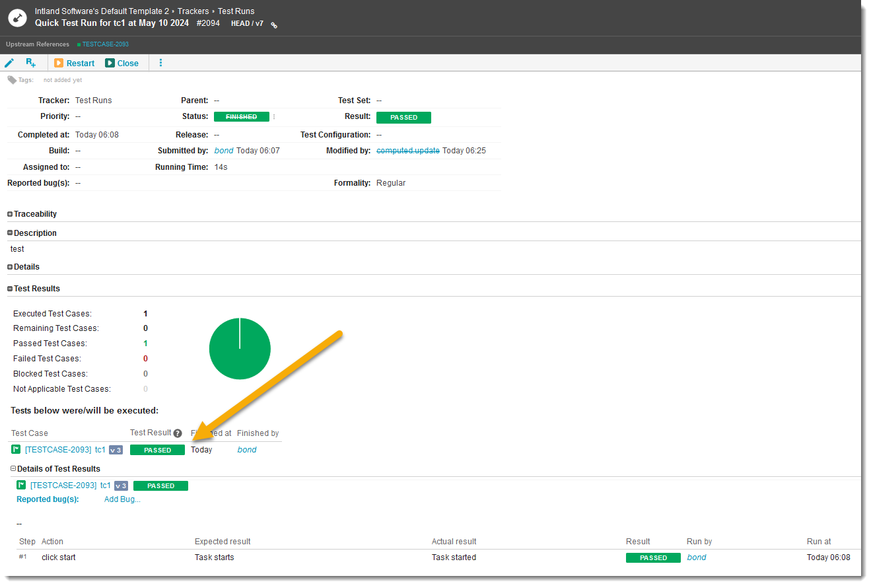

Hi, @YW_10142311 , I assume this is related to a Test Run. If so, to which part do you refer, is it the below?
alfonso_c
(To:alfonso_c)
@YW_10142311, you gave "Kudos" to my previous question, so I assume you are indeed interested in getting that field with REST API or computation.
To get the Test Result of a Test Case's Test Run, you can chain 2 REST API calls:
1) Assuming the Main Test Run has ID 2094 as in my screenshot above, get its child items with GET /v3/items/2094/children:

2) Once you have the child item ID (2095), you can query its fields with GET /v3/items/2095/fields, the JSON will contain a part about the result:
      "fieldId": 15,
      "name": "Result",
      "values": [
          "id": 1,
          "name": "Passed",
          "type": "ChoiceOptionReference"
      "sharedFieldNames": [],
      "type": "ChoiceFieldValue"
With computation, you can e.g. add a custom Text field with the resolutions[0].name formula:
Does this help you?
