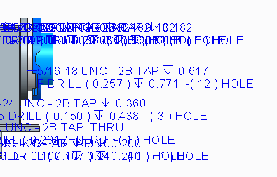

I updated my system to m080 late last week, this morning I notice this.
[cid:image001.png@01CEE9C6.A972EA00]
It wasn't like this in m070.
How do I turn this off?

The screen shot is from assembly mode.

[cid:image002.png@01CEE9D9.066D1430]
Once in Creo, click the annotation display circled in red. I'm sure there is a config that will default this to off.

Here's a part mode screen shot.
[cid:image002.png@01CEE9C8.531E78C0]
David Haigh
There was a change where the Creo was looking for configs between two build codes of CP2. I'm guessing your company config in the install hid these by default.

The config option is
[cid:image001.png@01CEE9C8.C44D14C0]

So I tested this in m070 and m080 without the config option in either version.
* M070 the hole notes don't display in part and assy mode
* M080 the hole notes do display.
The only fix is to add the config option to m080 and set it to no.

It’s setting the initial display of this button to be off:
It’s on by default.
When I’m designing I don’t want to see any annotation, I only want to see dimensions when I’m modifying a feature, or assembly constraint.

So I heard back from PTC on this. This is actually a fix of behavior that wasn't to spec before.
