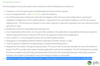

The scope of Creo Toolkit Support Team is defined here: https://www.ptc.com/en/support/csguide/Guidelines_Legal/Requirements_for_Customization_Support
These requirements have been set to warranty quality of service and accountability.
Integrating C# code in C++ code has less to do with Creo Toolkit and more to do with coding in general and more precisely IDE setting.
That's the reason, you were suggested to ask a question on a general forum even none PTC ones.
Hoping you will find the help you need.
Best regards
