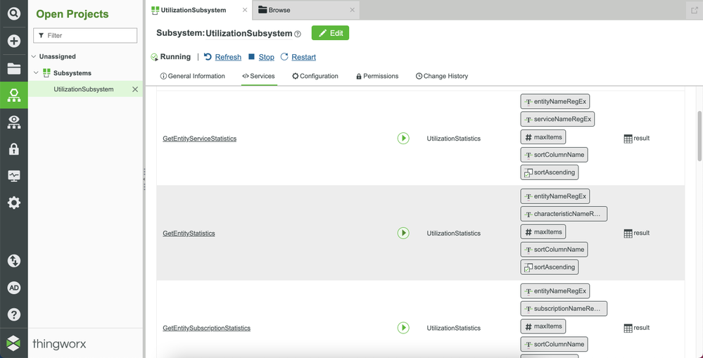

In the subsystem Services tab, you can select "UtilizationSubsystem" from the filter drop down and you will see all of the relevant services to retrieve and reset the statistics.

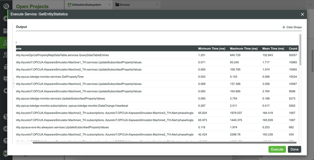

Here I'm using the GetEntityStatistics service to get entity statistics for Services and Subscriptions.
Giving us something like this. 

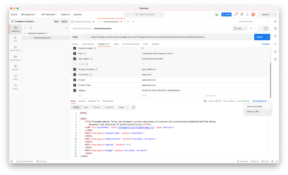

I have used Postman to do the same REST API call and to format the results as HTML and to save these results to file so that they can be imported into Excel.
You need to call '/Thingworx/Subsystems/UtilizationSubsystem/Services/GetEntityStatistics' as a POST request with the Content-Type and Accept headers set to 'application/xml'.  Of course you also need to add an appropriately permissioned and secured AppKey to the headers in order to authenticate and get service execution authorization.
You'll note the Export Results > Save to a file menu over on the right to get your results saved.

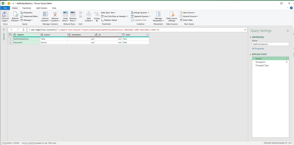

From the Data ribbon, select Get Data > From File > From XML.  Then find and select the HTML file saved in the previous step.

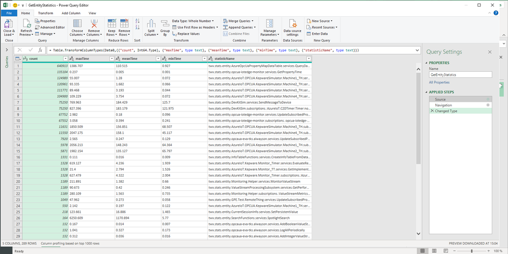

Once it has loaded the file and done some preparation, you'll need to select the GetEntityStatistics table in the results on the left.  This should display all of the statistics in a preview table on the right.
Once the query completed, you should have a table showing your statistical data ready for... well... slicing and dicing.

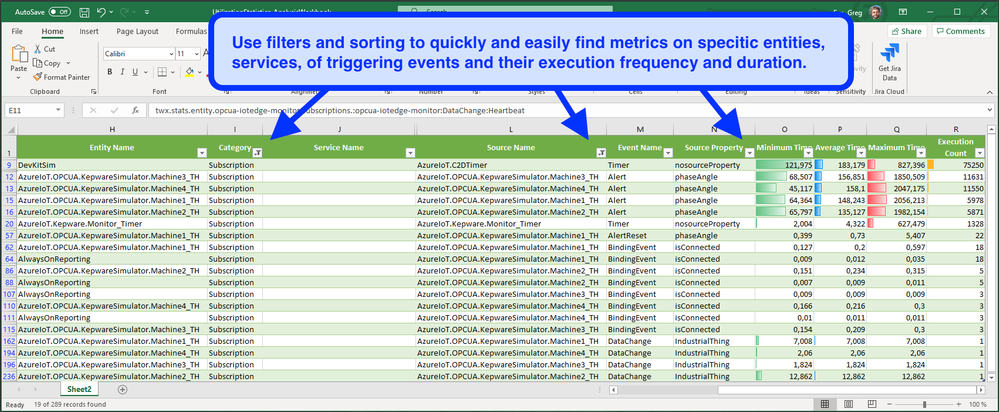

The good news is that I did the hard part for you, so you can just download the attached spreadsheet and update the dataset with your fresh data to have everything parsed out into separate columns for you.
Now you can use the column filters to search for entity or service patterns or to select specific entities or attributes that you want to analyze.  You'll need to later clear the column filters to get your whole dataset back.
