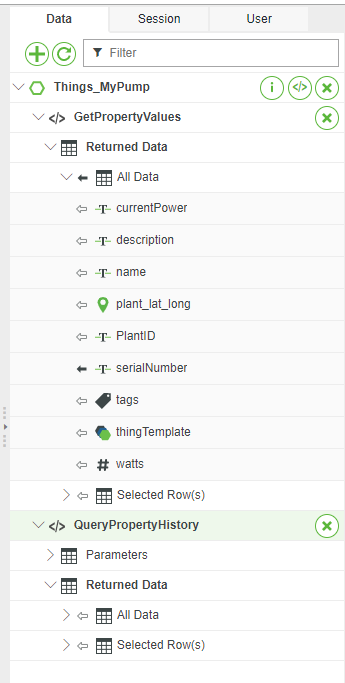

Now that we have access to the backend data, we want to bind it to our Widgets.
Value Display
Configure the Value Display to display the SerialNumber of the pump.

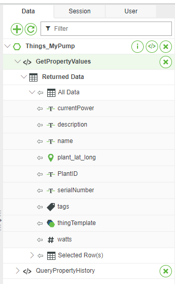

  1. Under the Data tab, expand GetPropertyValues > Returned Data > All Data.
  2. Drag-and-drop GetPropertyValues > serialNumber onto the Value Display Widget in the top section.
  3. On the Select Binding Target popup, select Data.

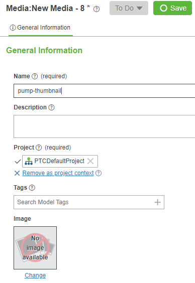

  2. Click Browse > Visualization > Media.
  3. Click + New.
  4. In the Name field, type pump-thumbnail.
  5. If Project is not already set, click the + in the Project text box and select the PTCDefaultProject.
  6. Under Image, click Change.
  7. Navigate to and select the pump-image.png file you just downloaded.
  8. On the navigation pop-up, click Open to close the pop-up and confirm the image selection.
  9. At the top of Foundation, click Save.

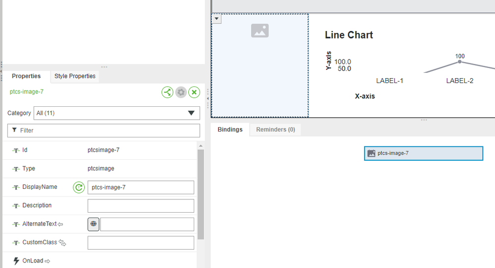

Change Image to pump
We will now update the Image Widget to display the ThingWorx Media Entity we just created.
  1. Return to the pump-dashboard Mashup.
  2. Click the Image Widget to select it, and ensure that the bottom-left Properties tab is active.
  3. In the bottom-left Properties' Filter field, type SourceURL.
  4. For the SourceURL Property, search for and select pump-thumbnail.
  5. Click Save.

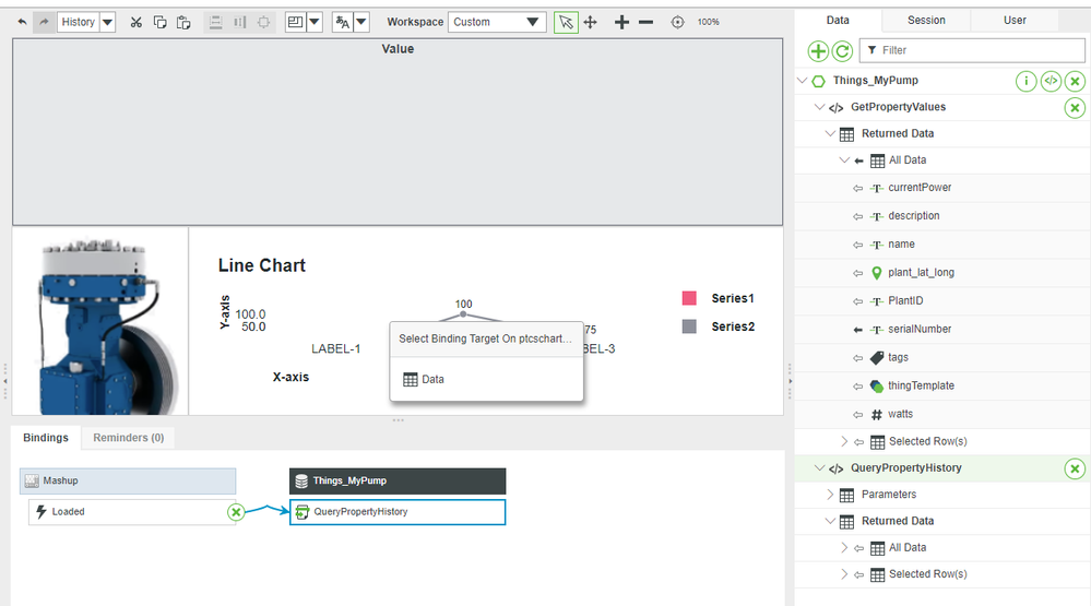

Line Chart
Configure the Line Chart to display Property values changing over time.
  1. In the top-right Data tab, expand QueryPropertyHistory > Returned Data.
  2. Drag and drop QueryPropertyHistory > All Data onto the Line Chart Widget in the bottom-right Canvas section.
  3. On the Select Binding Target pop-up, select Data.

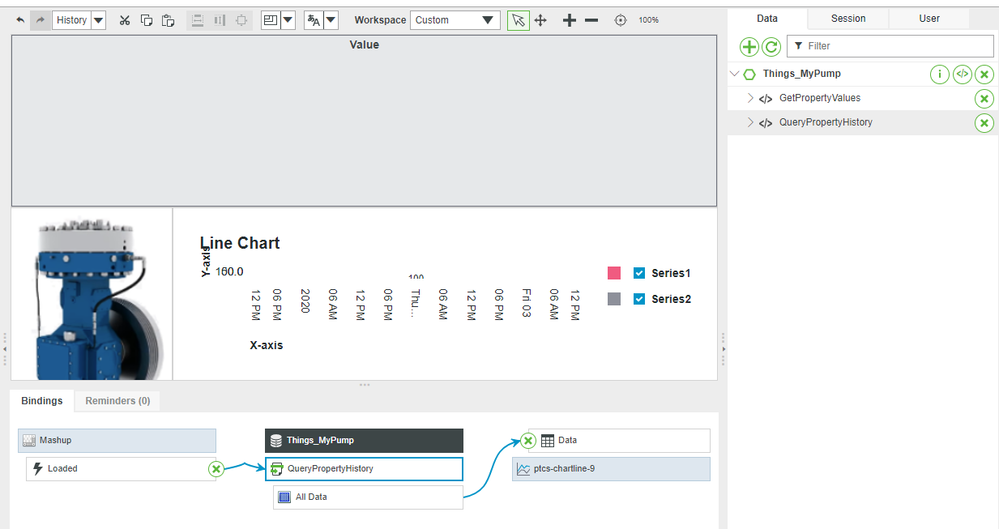

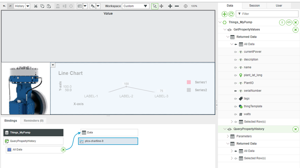

Verify Data Bindings
You can see the configuration of data sources bound to Widgets in the bottom-center Connections pane.
  1. In the top-right Data tab, click GetPropertyValues.
    • Check the diagram in the bottom-center Connections window to confirm a data source is bound to the Value Display Widget.
2. Also in the top-right Data tab, click QueryPropertyHistory.
    • Confirm that the diagram shows it is bound to the Line Chart.

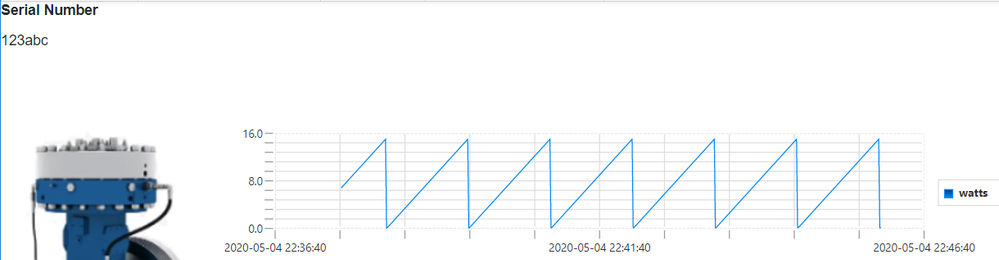

Step 6: Test Application
  1. Browse to your Mashup and click View Mashup to launch the application.
NOTE: You may need to enable pop-ups in your browser to see the Mashup.
2. Confirm that data is being displayed in each of the sections.
