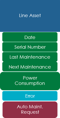

Step 3: LineAsset Thing Template
After prioritizing and grouping common functionality and information, we came up with the list below for the first Thing Template to create, LineAsset with five Properties, one Event, and one Subscription. The breakdown for the LineAsset Thing Template is as follows:
Follow the below instruction to create this Entity and get the implementation phase of your development cycle going.

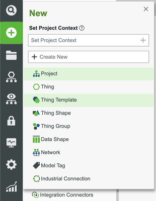

  1. In the ThingWorx Composer, click the + New at the top of the screen.
  2. Select Thing Template in the dropdown.

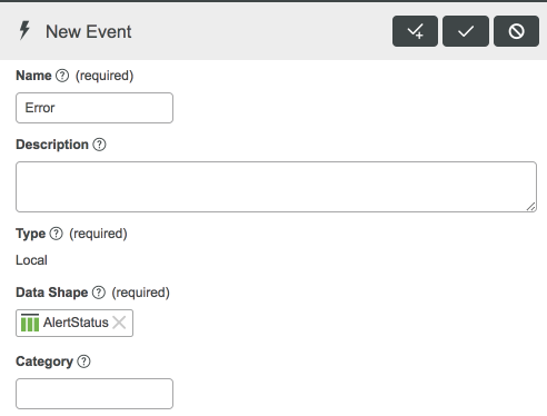

Line Asset Event
  1. Switch to the Events tab.
  2. Click Add.
  3. Enter the name of the Event (ie, Error).
  4. Select AlertStatus as the Data Shape. This DataShape will allow us to provide simple information including an alert type, the property name, and a status message.
  5. Click Done.
Your Event should match the below configurations.

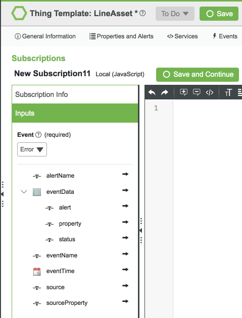

Line Asset Subscription
  1. Switch to the Subscriptions tab.
  2. Click Add.
  3. Check the Enabled checkbox.
  4. Switch to the Inputs tab. Select the name of the Event (ie, Error).
  5. Click Done.
Your Subscription should match the below configurations.
