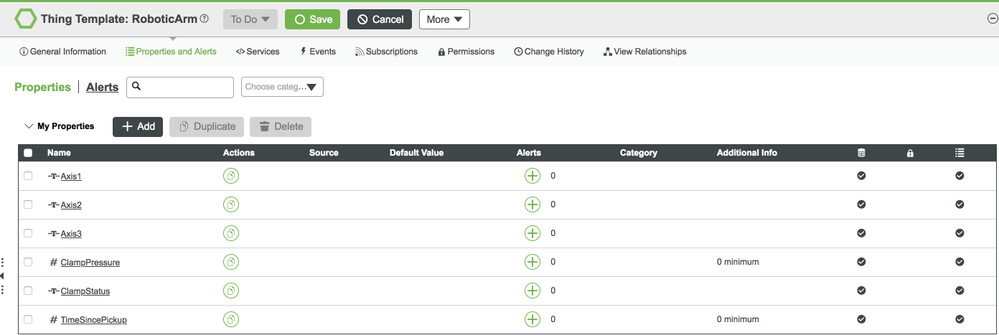

Robotic Arm Properties
The properties for the RoboticArm ThingTemplate are as follows:
Name
Base Type
Aspects
Data Change Type
TimeSincePickup
NUMBER, Min Value: 0
Persistent and Logged
ALWAYS
Axis1
String
VALUE
Axis2
String
VALUE
Axis3
String
VALUE
ClampPressure
ALWAYS
ClampStatus
String
ALWAYS
Your properties should match the below configurations.

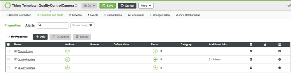

Quality Control Camera
Properties
The properties for the QualityControlCamera ThingTemplate are as follows:
Name
Base Type
Aspects
Data Change Type
QualityReading
INTEGER, Min Value: 0
ALWAYS
QualitySettings
String
ALWAYS
CurrentImage
ALWAYS
