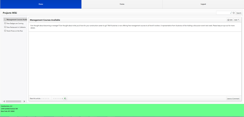

This project will introduce how to get your application ready for usage by actual users or ready to collect data.
Following the steps in this guide, you will be ready to present your finished application to users so they can benefit from its functionality. Deploying your application provides the ability for users to access it from anywhere, anytime and enables your edge devices to communicate with your application 24/7.
We will teach you how to deploy your ThingWorx IoT application to be ready for whatever experience you've molded it to be.
