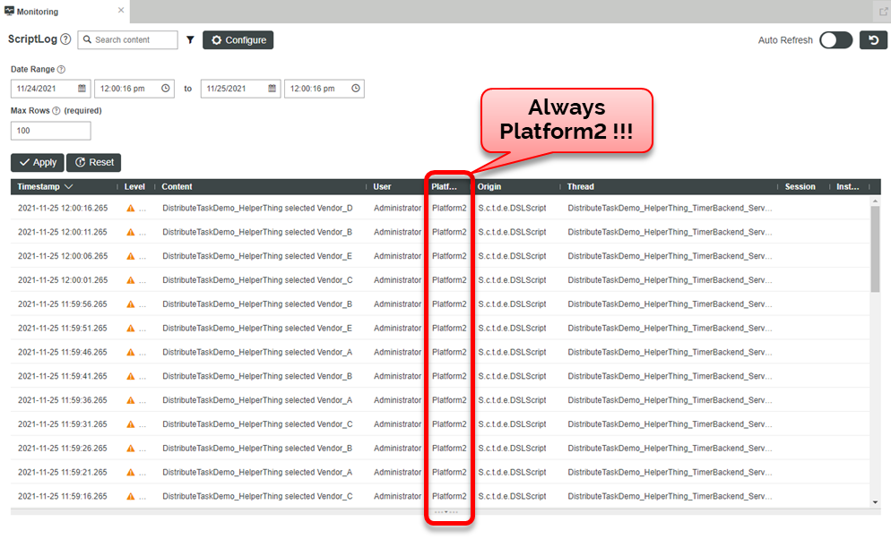

Now with that code in place, let's check where these services are being executed in the ScriptLog.
Look at the PlatformID column in the log… notice that that the Timer and the helper utility are always running on the same node – in this case Platform2, which is the current singleton node in the cluster.
As the complexity of your helper utility increases, you can imagine how workload will become unbalanced, with the singleton node handling the bulk of this timer-driven workload in addition to the other workloads being spread across the cluster.
