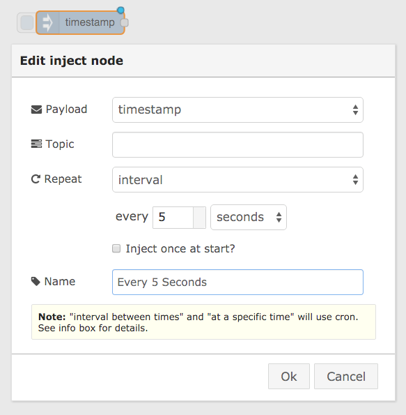

In the Java SDK version of this example, we are polling for changes in data. Every so many seconds our device will wake up and take a reading. How do we recreate the same effect in Node Red without having to push an inject button every 5 seconds. No. We need an input node that activates on its own every 5 seconds. The Inject Node will do this. Drag out an inject node and configure it as shown below.
This is an input node so it will be starting a new flow. It will fire off every 5 seconds from the minute this sheet is deployed.

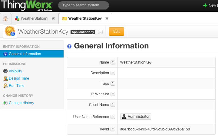

Next, create an Application Key in the application keys section of the composer. Assign it to the "Administrator" user.
Your keyId will of course be different. This key will be the credential you need to post your data.
