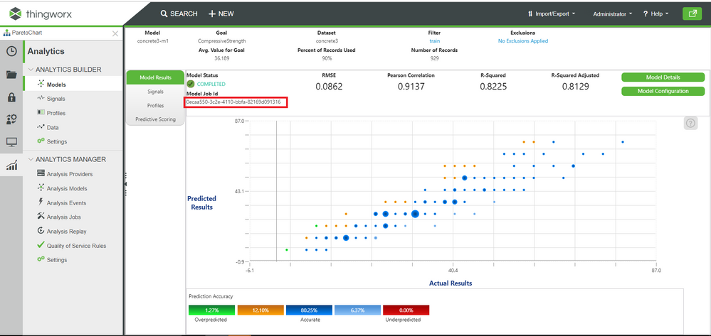

Hi, I think on Thing ConcreteHelper you should set ModelID = c2054f0a-afb2-4880-b471-3cd13a574efa
This should be the same ModelID that you see in Analytics Builder as shown in the below screenshot.
Thanks, modelID mistake was the reason for 403 error. Now I have a new one:
