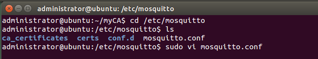

They are referenced in the /etc/mosquitto/mosquitto.conf file like this:

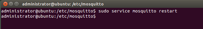

After copying the files and modifying the mosquitto.conf file, restart the server:
$ sudo service mosquitto restart

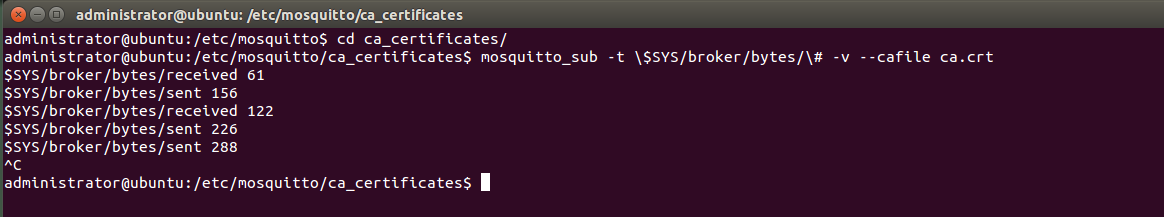

To validate the setup at this point, use mosquitto_sub client:
If not already installed please install it:
Change folder to ca_certificates and run the command :
The topics are updated every 10 seconds. If debugging is needed you can add the -d flag to mosquitto_sub
