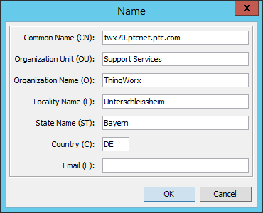

Leave the other defaults and fill out the Name (addressbook icon).
Only the Common Name is required - usually I never use the Email field, as I want to avoid receiving more spam than necessary.

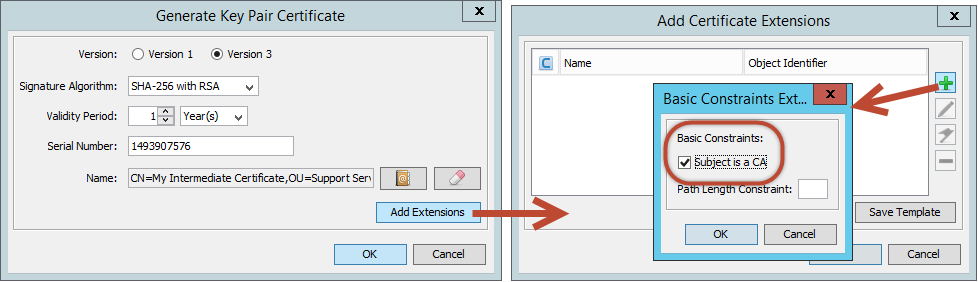

Fill out the Name again - this time as Intermediate Certificate.
A Intermediate Certificate is a Certification Authority (CA) in itself.
To reflect this, a Basic Constraint must be added via Add Extensions.
Mark the checkbox for Subject is a CA
Confirm with OK, set the alias (or leave the default) and set the password for the private key part.
