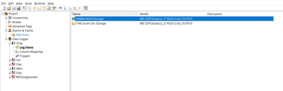

Here is screenshot of my datalogger:
I type in this command to the browser:
http://127.0.0.1:57412/config/v1/project/_datalogger/log_groups/1Day/Log_items/
and get this result that I can then manipulate into Bruno API (freeware)
