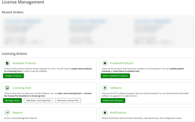

Solution -
Steps:
Log in to License Management Portal using your PTC user ID and password
Refer to The Manage Licensing Application PDF, pages 48-54, for detailed instructions.
NOTE:  If you do not have an account with license administration privileges,
Contact "PTC License Management team"
Log a case with License Management
