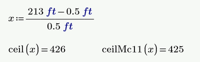

Does anyone know why the attached issue is occurring? It seems that when you run units of feet, there is some kind of internal rounding error.

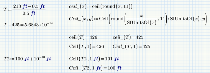

While the result looks like its exactly 425
we can see by calculating the difference that actually due to rounding/conversion errors its ever so slightly larger, hence Ceil an ceil come up with the next higher integer 426.

Real Mathcad sure shows the same problem, here Mathcad 15
Don't know why ceilMc11 does better than ceil. I would have thought that both would access the same (inaccurately) stored value of x. Apparently not.
(real) Mathcad 11:
Guess there's some smartness built in....

Maybe something like

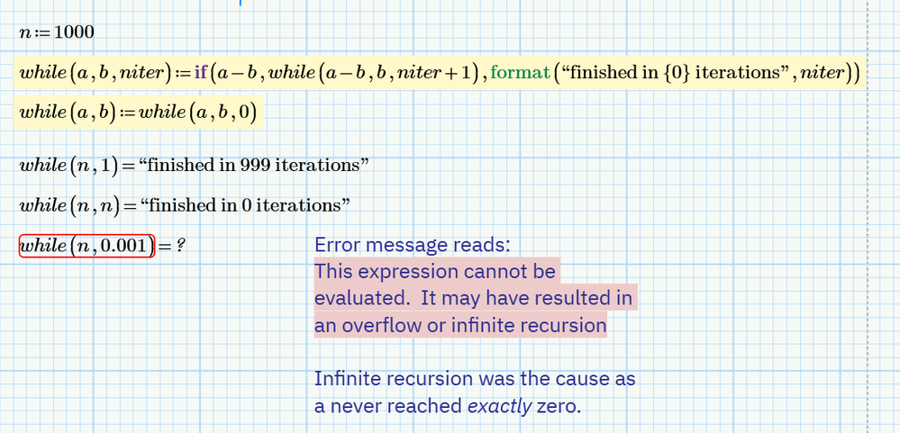

It's not just when units are involved.  Unit conversions are one example of where this can occur, but it can occur in unitless calculations as well, simply because there might not be an exact 64-bit binary representation of a given decimal number.   Here's an example where repeated subtraction works for integers, but can fail for decimal fractions.
(I used a recursive definition of the while function because I only have Mathcad Express, so no programming)

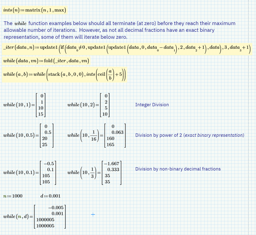

Arggh!  Belay the above example.  That was a genuine recursion limit.   1000 / 0.001 = 1000005, which is way beyond Mathcad's recursion limit (about 4700, IIRC).  The following uses the undocumented function fold to get around the recursion depth limit.
You'd think I'd remember how low the recursion depth limit was, as I'd literally just been working on some Express-friendly functions specifically designed to get around that limit.  But, oh, no, not me.  👿
Honestly, if I didn't have my head screwed on, I'm sure I'd forget ... Drat, where've I put the blessed thing now?
Mathcad Express 10 worksheet is attached so that others can identify the obvious mistake(s).
