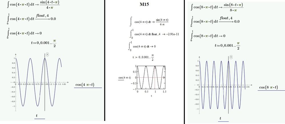

I just got Prime 7 and tried to do a sample calculation for a class.  It doesn't seem to be able to evaluate a very simple integral.  V15 and MATLAB both get the right answer with no problem.   The weird part is that it only gives the wrong answer when the number is 4.  I didn't see a problem with other numbers.  This was for a lesson on Fourier series.
Hopefully, the problem is me and not Prime 7.  I most appreciate any suggestions.

I'm sorry, but the problem is not you, but Prime 7.
Better stick with Prime 6, where it was still OK:
Which means that PTC (again) managed to make things worse.
But it does get better in Prime 7 when you split the integral up:
And then it doesn't matter how you split it up:
If you're a licensed user, report this serious bug to PTC.

Thanks for the example.  It appears to work as a symbolic calculation in Prime 7, but not a numerical one?

Another oddity:

This is interesting.  The lesson seems to be that there are ways around the problem, but you have to notice the problem and know the workarounds.

This is (probably) a fairly exotic failure due to a change in the software (Every improvement involves a change, but not every change is an improvement. Admitted: every deterioration involves a change, but not every change is a deterioration.). Personally I wonder what produces this value of -0.151365...; I cannot relate it to anything known.
Even if  PTC have a rigourous testing vehicle to check correct functioning of their software (within which they now should include a test for this scenario), such failures can always happen. If they henceforth test for the integral with 4 pi, next time it may fail with 16 pi, who knows....
One way around that could be that all numeric answers would be checked by having the symbolic processor produce an answer on the same problem for verification, before the answer is displayed. Unfortunately not all problems can be solved symbolically, but more importantly: You would probably not want to pay the price in performance...

The two processors (numeric <=> symbolic) function independently, with different algorithms. It is not uncommon that they produce different answers to a certain task, especially so when the answer is debatable from a mathematical standpoint. One example is the heaviside step function.
In Mathcad 11:
In Prime 7:
I wouldn't be surprised if the symbolic answer in Prime7 would be 1.
