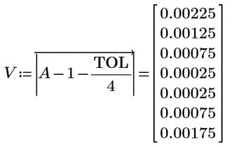

Because this function uses 'exact' equality and not that weak "equ" , it may miss values just because tiny round-off errors.
For example using Lucs vector A (using default TOL=10^3)  the following function call should return indices 3 and 4, but index 3 is missing:
The absolute values of the differences at index 3 and 4 should be equal
But when we look closer we see that the value at index 3 is slightly larger
The usual workaround is not to ask for exact equality but rather for approximate equal within a certain tolerance
