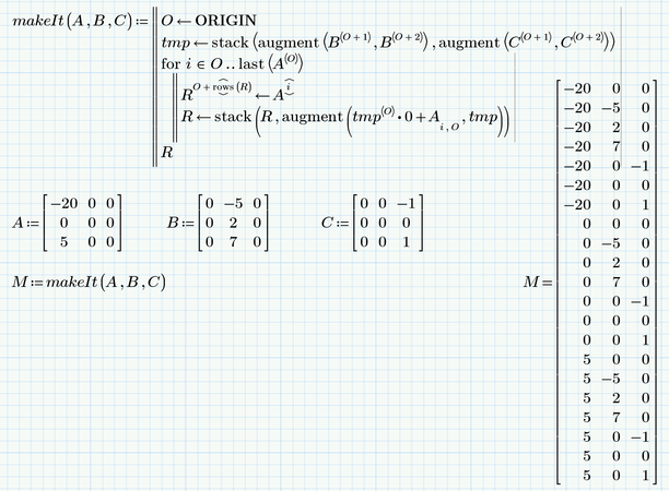

This little program should do the job:
Worksheet in Prime5 format attached

Great !!
i try to understand it Smiley Happy

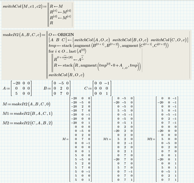

I need to make a matrix  M1 with B mark
for example:
0     -5     0
-20  -5     0
0     -5     0
5     -5     0
0     -5     -1
0     -5     0
0     -5    1
And third make a matrix M2 with C mark
for example
0     0     -1
-20  0     -1
0     0     -1
5     0    -1
0     -5     -1
0     2   -1
0     7    -1
(To:XDN)
See if this does what you need for M1 and M2, making use of Werners function.

Great Luke
i make a new parameter
A'
B'
to match with werner's algorythm
