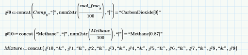

I´m using with great success the Coolprop wrapper, but one challenging task is to form the "mixture" string.
Air for instance must be written as: "O2[0.21]&N2[0.79]"
When working with complex mixtures, like up to 10 components, my idea was to use a table and extract a "concat" function from the table. All good doing it the hard way:
Problem: if I add or remove one of the 10 components from the table, maybe for a simpler composition, then the formula for "mixture" would fail.
Solution: maybe write a program? But don´t even know how to start.

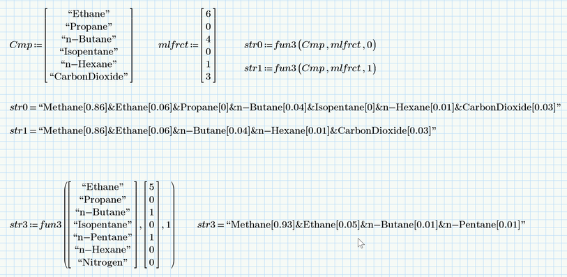

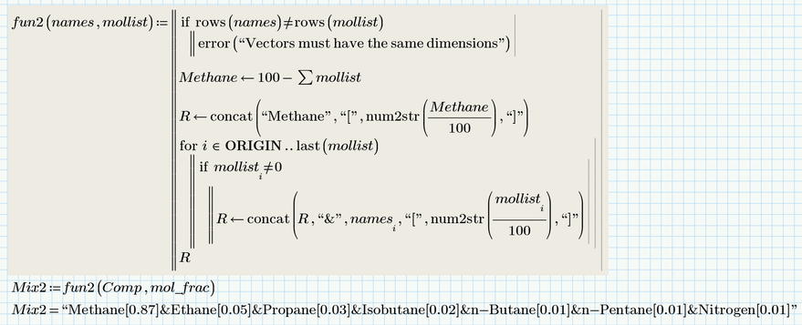

Here is a function which creates the string, including zero values
Here is a slight modification so that zero values are omitted
And here is a function which can do both, depending on its third argument
Attached file is in format P9. Maybe someone ( @LucMeekes ?) can convert it to P8 format or lower.
EDIT: There were copy & paste errors in the first version of the functions. Is now fixed.
Here's the file in Prime6.
