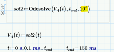

I am not sure why Prime is thinking so long...I do not remember why, but in the morning I was able to see the good result from this odesolve block...for V4(t)
V3(t) comes from above:
Cornel
(To:Cornel)
After restarting the Prime, it started to work ok
Anyway, I see that there is a relationship between
tend  and the last value in odesolve:
Look at the V4(t) plot,
But if I increased to 10^4
V4(t) plot looks good now:
There is still missing one:
Missing another green:
(To:Cornel)
Quite interesting. You may call it a bug and report it to PTC support and wait what they say.
I had success by providing guess values for V2 and V3 depending on t but I would not dare to say that this is a general solution.
