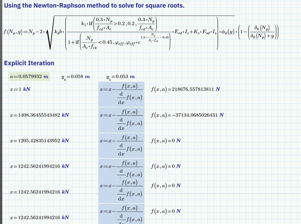

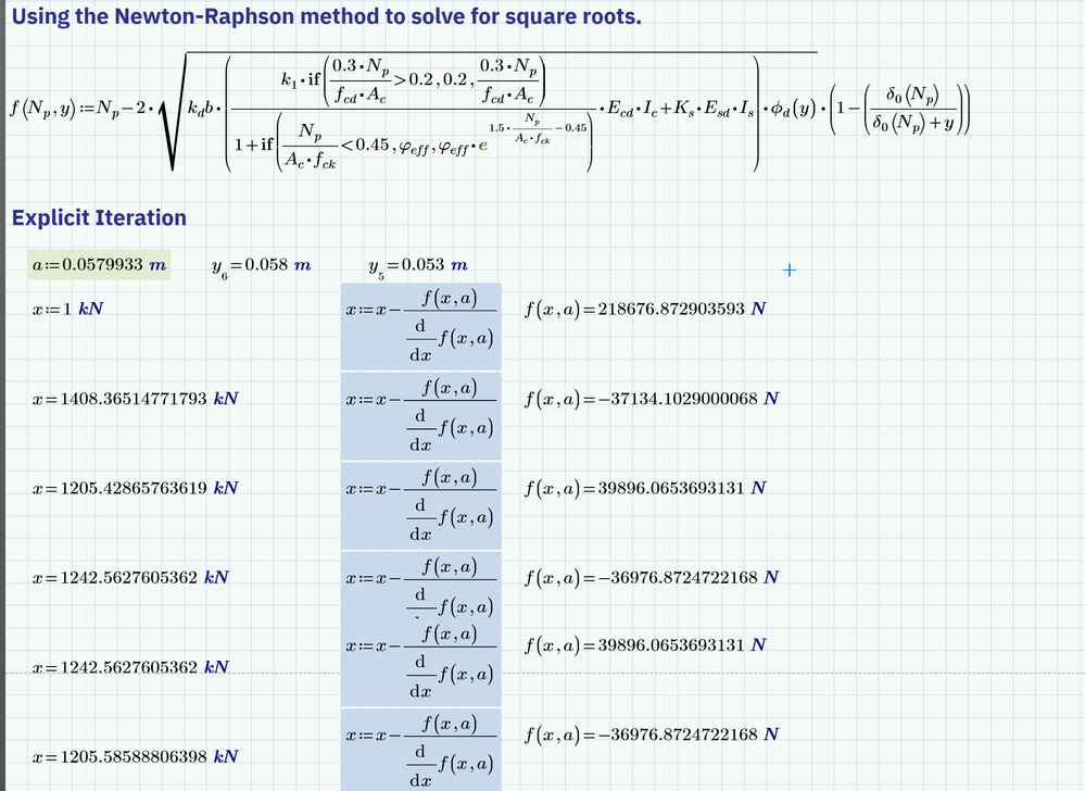

There is nothing wrong with your script. The problem is that changing from fp to fd results in an expression that causes root to fail to find a solution. The error message relates to root's attempt to find a solution ... possibly resulting in a complex value. If you look at a Newton-Raphson approximation for the root then you can see that once y gets beyond a certain value, then the approximation oscillates (ie, the derivative is rather flat and therefore sensitive to small changes in Np. root's algorithms are more sophistiated than Newton-Raphson but they have their own limitations as well.

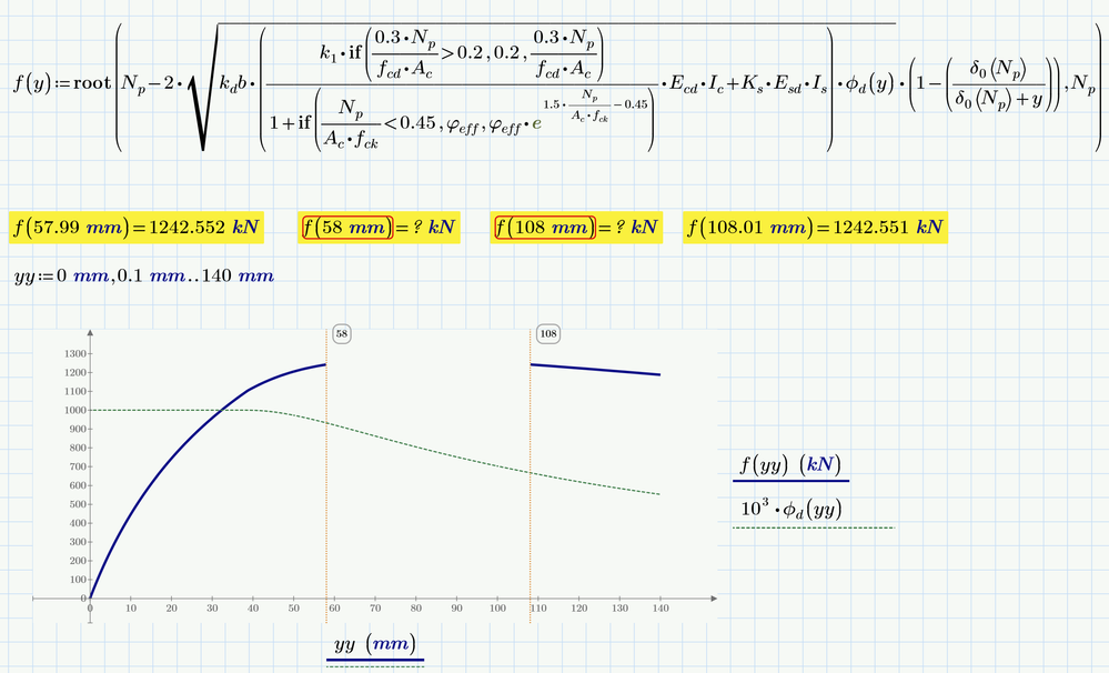

As a first quick workaround you can throw in a try and catch statement
So it can be seen that the last two values in vector y are throwing the error
I turned your calculation into a function of y and it can be seen that it works OK for values of y smaller than 58 mm and throws that error for y=58 mm or larger. It works again for y>108 mm.
The error message sure is misleading because the expression where the error is shown is independent from the value of y. Nonetheless the value of y and something in the function Phi.d seem to be responsible. Could not be tempted to further look in your function definitions with those nasty nested if functions.
Phi.d itself has no problems with values of y larger than 58 mm.

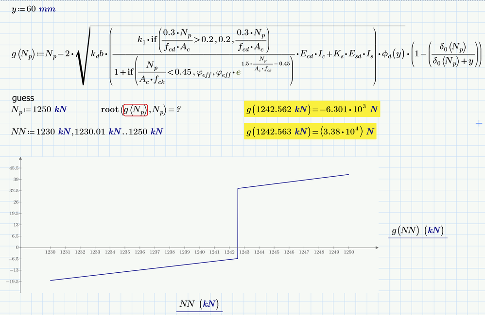

I defined the function g dependent on N.p you are looking for its zero and used y=60 mm (a value where the calculation would fail),
It can be seen that there is no zero of this function!! Because of the various if-statements in your definitions of the various functions involved we can clearly see a jump from negative to positive values somewhere between N.p=1242.562 kN and 1242.563 kN.
So root can't find a solution. My guess as of this misleading error message is that root in its desperation might try values for N.p which may return non-real results in some functions (possibly delta.0). Not sure about this, though.
So the solution is that you have to check your functions and make sure that they are continuous where you are looking for the zero of a function.

Here I had chosen y=60 cm, a value where your calculation using the root function fails. The function g(N) represents the expression you use in your root function. This is the expression which you want to be zero and look for the appropriate value of N.
And the plot clearly shows that there is no value of N which makes this function to zero because there is a discontinuity at approx N=1242.562 kN
The root command can't find something which simply does not exists!

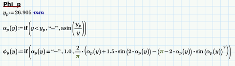

The thing that I find strange is that the functions Phi_p(y) and Phi_d(y) are more or less identical except for the fact that y_p and y_d (constants) differ and there is no problem solving the roots for the Phi_p function only for Phi_d. I have a hard time understanding that.

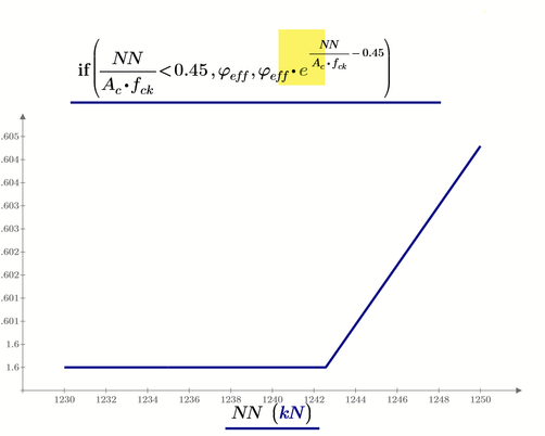

The picture also shows the reason for that jump, which is present for all values of y and also in both function (the one using phi.d and the one using phi.p). Its the if-statement in the denominator. The jump occurs when the value goes over 0.45.
It looks like this
I am not sure if the jump here is really correct and intended, Normally I would expect a continous graph, like is the case in the if-statement in the nominator.
