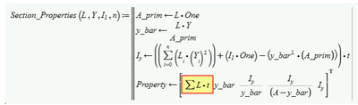

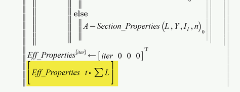

What  I am trying to accomplish is to have the effective area which is the sum of L*t included in my effective properties or have it report the vector L  of the last iteration then i will compute the effective area.  When i did what you suggested [ L  Effect_Properties] i was not getting an answer, as you're showing. I was getting the size of two matrices. What Ii did is the following, as shown below, and on page 4 of the sheet, is adding the term highlighted in yellow
On page 5, Draft view, is iterating in a manual way. As i mentioned before, i can have the variable "comp" equal to B or C. Is my approach correct? Also it will be good to report the last  L vector too. I have attached my latest sheet.

As t seems to be a constant (0.1) which does not change you may return t*sum of L as the second return value.
When you later call this function, you can assign it a 1x2 matrix so there is no need to display the nested matrix:
