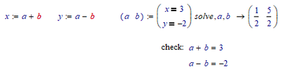

You have more work to do. I think you would be better off with two equations, like this:
Note that I would rather do this like:
But I cannot decide what the right equations would be for your problem.

Thanks alot, that is exactly what I wanted!
