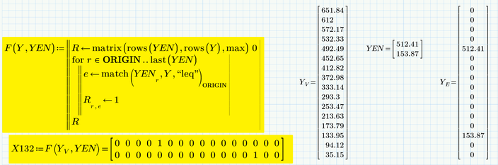

(To:ptc-2283641)
Here's the file, corrected and saved from Prime 3.1, so it should open in Prime 3.1.
I'll explain the program:
The first line creates R as a matrix of 0's, the size of which is determined by the numbers of rows of YEN and Y, using the matrix function, and sets it to all 0's by multiplying it with 0.
The second line starts the for loop, to go through all (at present 2...) elements of vector YEN.
Within that loop the first statement  uses the match function that finds all indices in array Y whose value is less than, or equal to th chosen YEN element's value. Given the values above, match finds the list of indices from ORIGIN to last(Y) when we're working with the first value of YEN. From that array, only the very first (the one with index ORIGIN) is assigned to e. So e holds the index where, for the first time, an element value of Y is below the chosen value of YEN.
In the second row the element of matrix R whose index is determined by r and e is set to 1.
The second time around in this loop, match should give a list of indices starting at the 12th element and on to the last. Again only the first of that list, the index pointing to the 12th element is assigned to e. An again at the chosen position in R a 1 is set.
When all elements of YEN are processed, the matrix R is returned as the function result.
