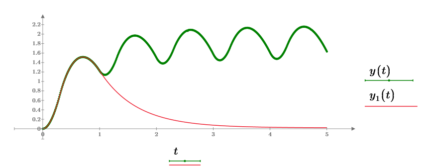

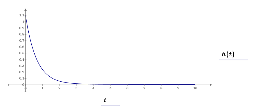

(To:ttokoro)
Answer 1.   By using covolution integral for 1 Hz problem.

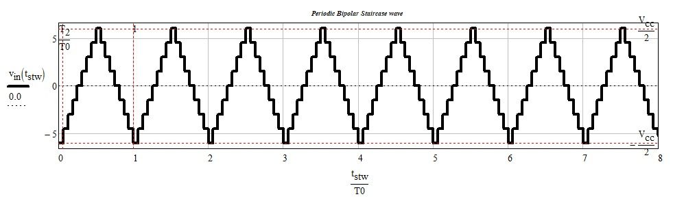

It would be more interesting to determine the response to this signal:
ttokoro

The applied voltage waveforms are below and their current responces are made by convolution integral.
ttokoro
(To:ttokoro)
Answer 2.   By using Laplace convertion for 1 Hz problem.
ttokoro
(To:ttokoro)
Answer 3. Use convolution to solve the 1 Hz response.
-MFra-
21-Topaz II
(To:ttokoro)
Congratulations on the results obtained.
ttokoro
(To:ttokoro)
Answer 4. By using Fourier analysys and Laplace transform for from DC to 20th harmonics.
Below I and V are missed. i(t) is applied voltage and v(t) is transient current responce.
Because I used former RCRC sheet to solve.
image.pngimage.pngimage.pngimage.pngimage.pngimage.pngimage.pngimage.pngimage.pngimage.png
ttokoro
(To:ttokoro)
Answer 5. By using solve block.
