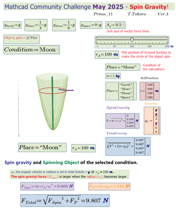

I decided to get in on the fun. Here is my worksheet in Mathcad Prime 11. This is a work in progress. I still need to throw in an optimization and take advantage of custom unit systems, especially for RPMs.
Dave Martin - dmartin@creowindchill.com - https://www.mcaeconsulting.com
I adore your gravity / radius sliders and the motion sickness conditionally formatted text box!

I've updated my worksheet to take advantage of a couple Prime 11 enhancements:
  • I am using a custom unit system so that the default unit for frequency is RPM instead of Hertz.
  • I duplicated the text box with conditional formatting to be written in Python in addition to JScript.

Prime 11. Ver. 2a. T.Tokoro.
Having the spinning object turn red (even more red than your screenshot) is very fun!

Prime 11. Ver. 3a. T.Tokoro.
Well, you're late... but your worksheet is cool, so I'll allow it anyway. 😀
