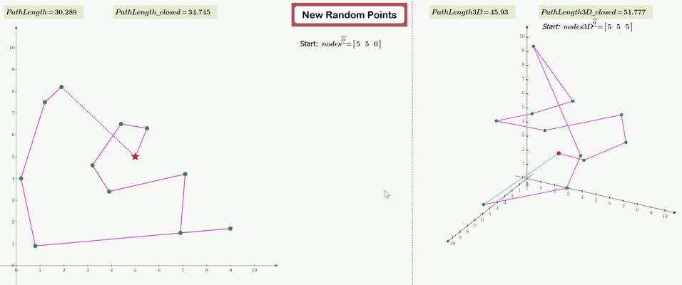

So it seems that you are just looking for something like this?
EDIT: Added the 3D version
Prime 10 sheet attached
Second version of my sheet.
Fixed an error concerning the selection of the start point.
It should read "nodes3D" here instead of just "nodes".
I also added a comparison of the path found using the greedy algorithm with the real minimal paths (both open and closed).
The minimal paths were found by brute force, calculating the path length for all paths with a constant starting point and all permutations of the remaining points. This is only feasible for a small number of nodes, so I added a threshold which avoids doing the calculation for a larger naumber of nodes. Set it to a higher value at your own risk 😉
We see, that the greedy algorithm sometimes really finds the minimum, often it doesn't but yields a solution which most of the times can be considered a good approximation, given the simplicity of the algorithm.

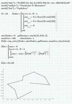

Made in 1.5 hours using AI.
tsp_solve Function Overview
I've created (Gemini) a powerful new function, tsp_solve, that integrates a Genetic Algorithm directly into Mathcad to find a near-optimal solution for the Traveling Salesperson Problem (TSP) in 3D Euclidean space.
This function returns the entire optimized route as a matrix, allowing you to visualize the path, calculate open or closed loop distances, and perform further analysis right inside your worksheet.
Function Signature:
tsp_solve(coords, startIndex, gaParams, generations, timeLimit)
Parameters:
coords: An N x 3 matrix where each row represents the (X, Y, Z) coordinates of a city or point.
startIndex: The 0-based index of the city (row in the coords matrix) that should be the starting point of the returned route.
gaParams: A 3x1 vector containing the core parameters for the genetic algorithm:
gaParams[0,0]: Population Size (e.g., 50) - The number of routes in each generation.
gaParams[1,0]: Mutation Rate (e.g., 0.02) - The probability (0 to 1) that a city in a route will be swapped.
gaParams[2,0]: Elitism Count (e.g., 5) - The number of best routes to carry over to the next generation unchanged.
generations: The maximum number of generations the algorithm will run before stopping (e.g., 1000).
timeLimit: A time limit in seconds that also serves as a termination condition (e.g., 10).
The algorithm will stop when either the generations count or the timeLimit is reached. It is also fully responsive and can be interrupted at any time by pressing the Esc key.
Return Value:
The function returns an N x 3 matrix with the same dimensions as the input coords matrix, but with the rows reordered to reflect the optimal path found by the algorithm. The first row of the output matrix will always correspond to the city specified by startIndex.

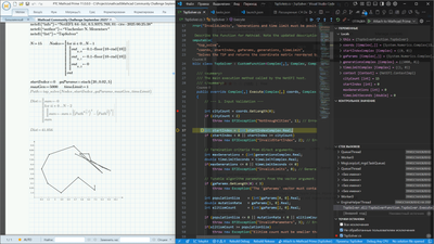

The project structure for VS Code has been updated (tasks.json).
Developing a project in this IDE is a fairly new endeavor, and you'll need some experience.
But the project itself is quite simple. More examples in different languages are available on GitHub.
You can debug your function
However, the end result was disappointing. It appears that AI created a custom external function. I don’t understand externally coded functions, but as a Mathcad user, I shouldn’t have to. While there is a Mathcad Prime worksheet, it lacks one of the core strengths of Mathcad as an engineering tool: documentation to communicate the problem, method, and solution to others, specifically other humans. This AI generated approach may or may not have achieved the right answer. But as I have discussed the past three years, getting the right answer is often not the most important part. Who knows, AI may be able to create worksheets that can both solve and communicate effectively (to humans) one day.

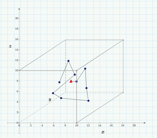

I've produced a 3D version of the original problem in Express. (my first attempt at including a 3D graph was a failure!). More effort required!
Alan
I've been strangely fixated on constructing a 3D graph in Prime 11 Express! Here's my 3D worksheet with an improved 3D graph construction (improved compared with my previous post that is).
Alan
