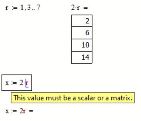

I think it's a serious BUG.
If, with the definitions of L and DLsw as given, this is allowed:
Then this should be equally allowed:
There was no such problem with Mathcad (11):
Are you sure? In your last picture of MC11 you did not try to assign the expression to a variable V.ADL !
The main difference and cause of the problem is this attempt to assign the 'calculation' to a variable!
And as far as I remember it was the very same in real Mathcad, too. At least it is in Mathcad 15:
Its a mis-use of a range variable. The bug, if we want to call it such, is that Mathcad allows the evaluation of an expression like 2*r with r being a range without throwing that very error, not that it refuses the assignment to a variable.
A range is kind of an implicit loop and and an expression using a range seems to be kind of an invalid object (so it can't be assigned a variable) but still can be displayed on its own without an error (which sometimes may be convenient).
So the behaviour in Prime is the very same as its in Mathcad(15)
