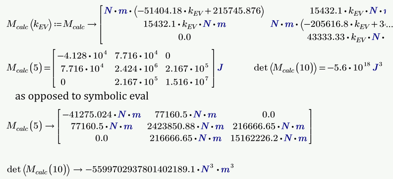

In case you need to see the matrix and its determinant for certain values of k.EV and would like to use numeric evaluation (maybe because of unit simplification), you may (re)define M.calc as a function (symbolic inline evaluation is mandatory here):
